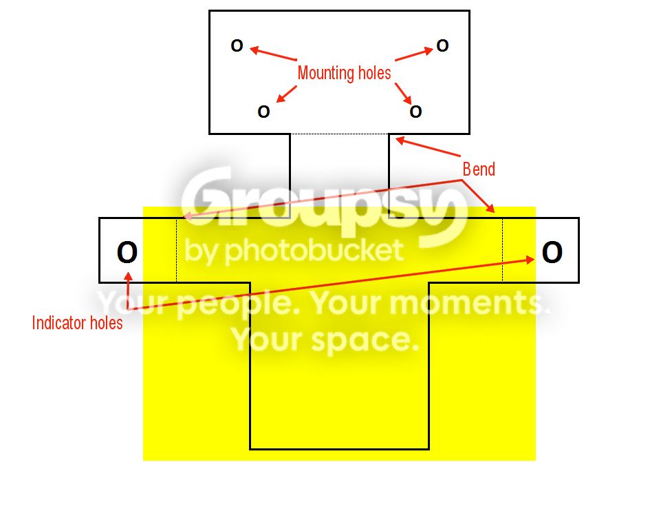

Below is a basic drawing (not to scale) of the idea. It's fairly simple to manufacture from a flat sheet of ally approx the size of a bit of A4 paper (but considerably smaller depending on number plate size and how far out you want your indicators to sit).
There are a three bends. The top one angles the number plate down so you can bend to suit. The other two are to mount the indicators so will need to be sized according to the indicators you choose. It should be possible to use the original ones though you will have a fairly complicated oval hole to cut out. Personally I would cut and bend the bracket before cutting the indicator holes or they will end up pointing in the wrong direction.
It should be possible to make the bracket so that it is pretty much invisible so don't get over excited about finish. Just paint it all black.
One other thing. The drawing shows square edges to all the corners but these should be rounded or else they will be more likely to fracture with vibration (especially at the bends). (I drew the thing in Excel so couldn't easily draw rounded off bits).

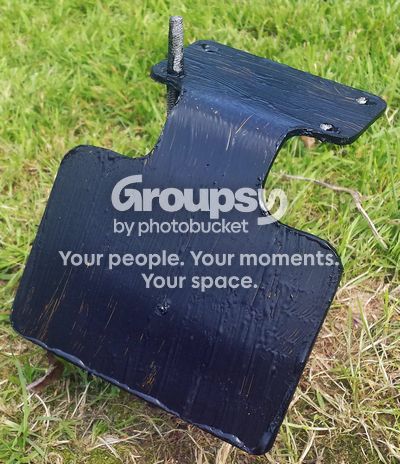

Picture one... The bracket.

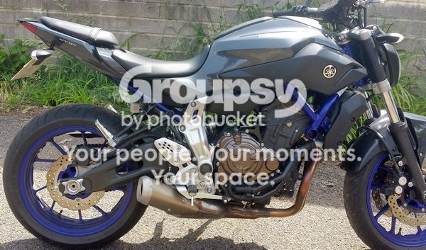

Picture two.... Where it mounts on the bike (Ignore the bent bit of ally marked up as "B" (that was from an earlier experiment).
