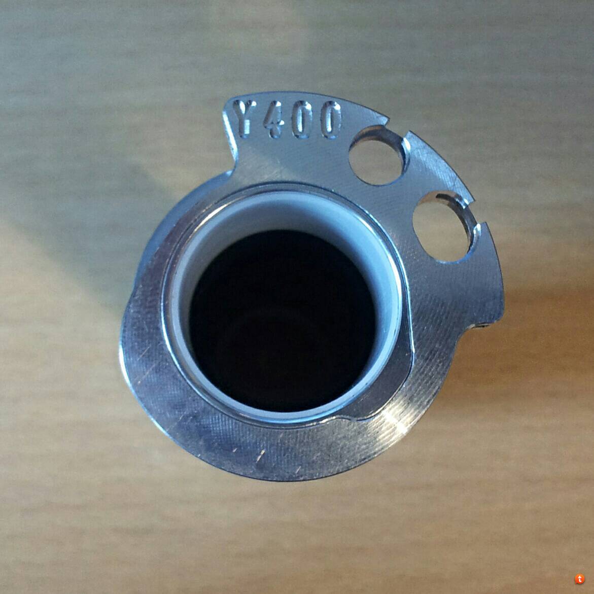

Tried my modded throttle over the weekend, result is much better. Although the initial movement from throttle off to throttle on is still abrupt, when it does initially come on its less of a jerk as at this point due to the cam you haven't opened the throttle as much as you would have using the standard throttle. Basically I found myself in A mode a lot more where usually I would have been in STD or B mode (through towns and traffic etc). Also out on the back roads throttle roll on mid corner was much more predictable.
That said it's still not what I would call 100% fixed, but at the end of the day I took a file to my throttle and filed a made up cam profile to it by hand so it was never going to be perfect, but it is heading in the right direction IMO. Will be very interested to try my G2 when it arrives as obviously that'll have a calculated machined cam profile so the result should be noticeably better again.
G2 Throttle Tamer arrived today, full review coming when it stops raining. For now though you can see how aggressive their cam is. Again it's a 20% smaller diameter for the 1st half of rotation then a ramp up to the original throttles diameter.
