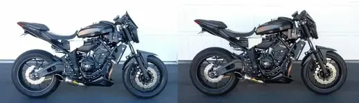

Finally got around to getting this thing installed!
Let me say this straight away...the DPM screen WILL NOT fit a US spec FZ-07 as-is.
The screen is meant to go over the turn signal housings on each side. The European turn signal housings are much shorter than the US Spec ones, so the screen will not sit flush on our bikes.
There are 2 ways around this...
1) Trim the sides of the screen higher, or cut them off altogether.
2) Use offset bushings to lift the screen up a bit to clear the turn signal housings.
In my particular case, my Suburban Machinery handlebars are more forward than stock, and as such puts the controls closer to the screen. Even if I trim the sides of the screen, it'll still hit my brake line and prevent it from sitting flush. Of course, I could notch it out to accommodate the brake line, but I decided to use the offset bushings instead just to see how it looks on the bike. I used nylon spacer bushings bought at ACE hardware, and found the exact same stainless steel hardware it came with, only in longer lengths. I used a 40mm length bolt for the rear, and a 35mm length bolt in the front. Again, same as the DPM stuff, only longer to accommodate the nylon bushings.
You can see I outlined the edges of the screen and turn signal housing in Green and Red, respectively. The Green edge of screen is supposed to go over the Red edge of the turn signal housing, but you can see here it's resting above it using the offset nylon spacer bushings...otherwise it won't fit.
