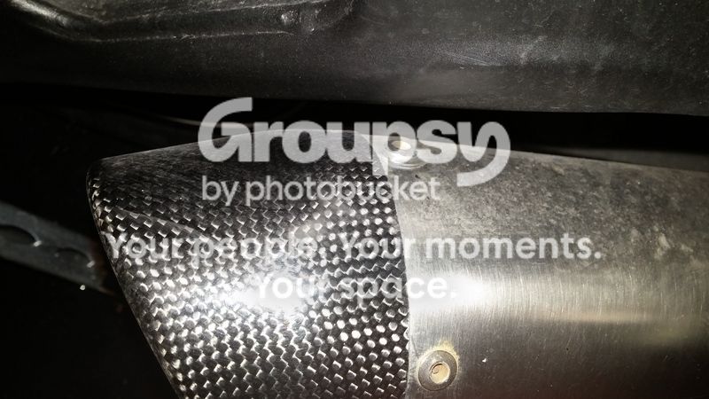

Hi Torque,
Fitted mine last week, and without washers my clearance is very similar to yours (perhaps even a little less). I have been riding the bike for a couple of hundred km since then, without any kind of problems. So even if it seems that the exhaust is very close to the swing arm, it haven´t caused any problems at all.
PS: VERY nice sound indeed :-)
DeadHead, it looks like your silencer is positioned in such a way that the swing arm could theoretically travel up and down any amount without restriction. Mine, however, is very slightly under the swing arm at its wide point where the carbon cap meets the silencer body. This is not a problem when the rear shock is under normal compression due to the weight of the bike, but I'd worry if I ever put the bike on a rear stand.
Could you confirm whether you have this slight overlap like me or whether yours is completely clear. Thanks for your time and also thank you BGL for replying.

I'll try and take another picture for you this time looking down over the the pipe to give you a better view.
If I hear from my dealers tomorrow I might not have the bike to take the picture for you as it's going in for part exchange.
and30ers might have a very valid point, one definitely worth looking at

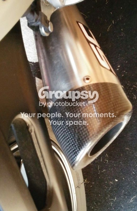

It's pitch black outside but rather than forget I took the picture for you..just in case I get the call tomorrow.
I put the bike on a paddock stand to show you the gap.
The gap showing in your image, is that the maximum gap whatever angle to take it from?

Hi Rappetor,
Thanks for your reply. Well I've fiddled with the headers and 2-1 section all morning and it's only gained me about 2mm difference at the silencer/swing arm, not a lot really but better than nothing :)
As far as I'm concerned it's now physically impossible to gain any more 'gap'. I agree about the flat surfaces that mate when the silencer is torqued up, short of bending something it will not go any other way!
I have inserted 4 M8 washers between the silencer bracket and bike which moves the silencer out a further 5mm to give it adequate clearance, but yesterday I emailed photos to SC and they said they would send me a spacer so that's good news.
They make these exhausts to order so I too wonder if there is a variation in the weld position. The good news is that it's on and it works! The sound is crazy good (even with the baffle in) and I'm sure the bike feels lighter and handles better.

Ok, so I'm also impressed with SC Project. I emailed them on Thursday about the clearance issue, and today I received the spacer as promised. Read the description above each photo for more information...
They actually sent me 2 spacers complete with individual bolt, cup, washer and nut assemblies. The 2 spacers have a width of 10mm and 15mm. I only needed to use the 10mm one.
They even sent a revised drawing in case I got stuck, lol.
Here's the spacer inserted into the mounting assembly.
Finally here's the resulting clearance between the silencer and the swing arm, perfect :D and well done SC Project.
