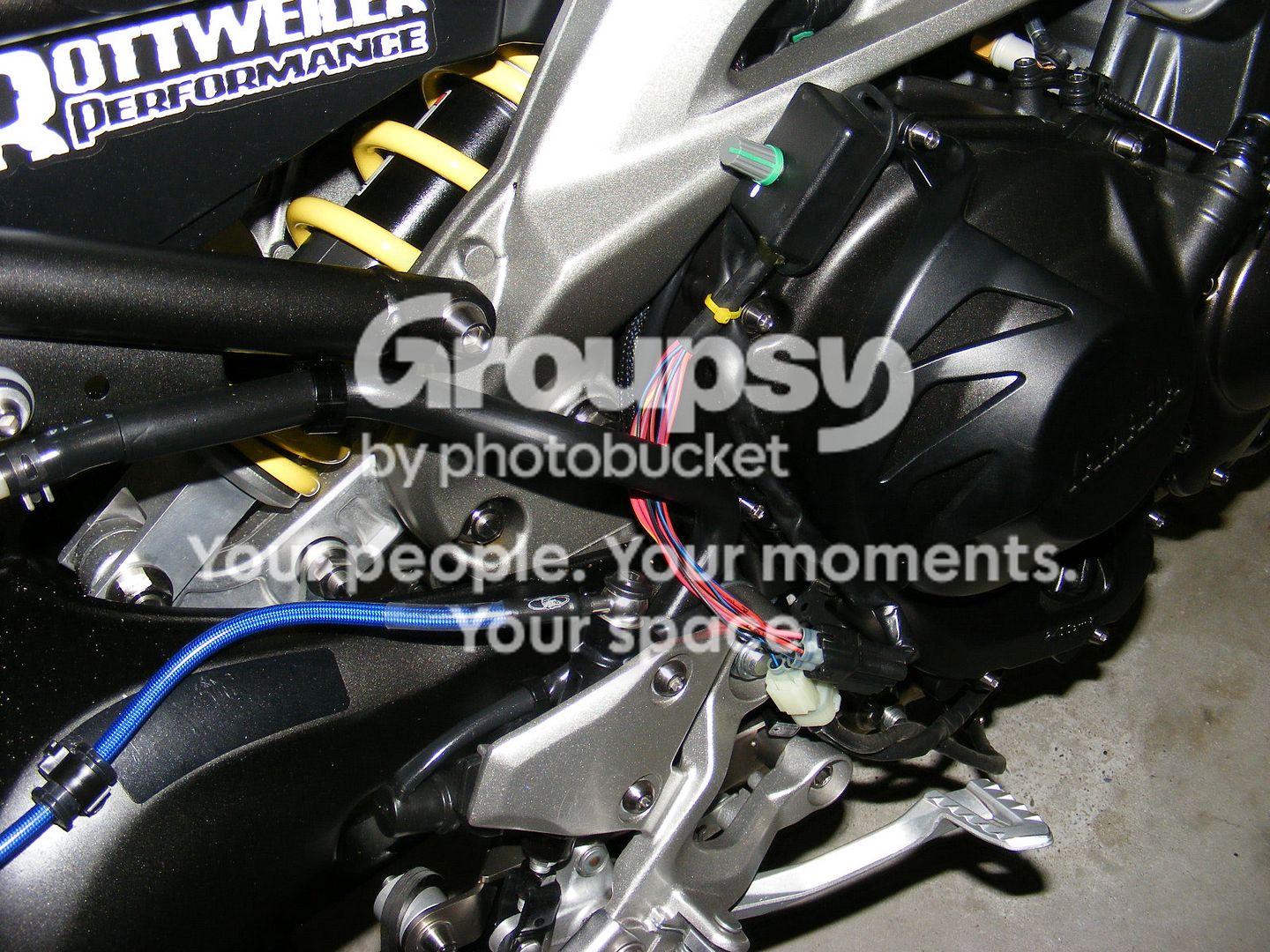

Did anyone else find it to be a rite Bar-steward disconnecting the oem O2 sensor plug after lifting the rubber boot,, 20 mins to fit kevs mod ? I spent 20 mins just trying to disconnect the plug :confused: fitted Kev,s controller today but not tried it yet due to good old UK rain again :(
Did anyone else find it to be a rite Bar-steward disconnecting the oem O2 sensor plug :(
Yes, it was a bit Fiddley, it was a bit misleading, what you thought were clips, weren't. It wasn't until i bent the bracket a slight bit that i could see how it came apart... After that it was a doddle...
