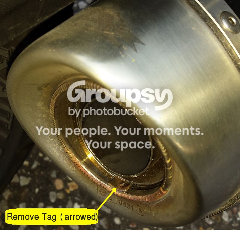

Pcture 1
First job is to pry off a little tag that has been spot welded to the silencer. I'd guess this is to conform to some sort of legislation so be wary of any legal implications it's removal may have.
Just wedge a small screwdriver under it and tap it with a hammer. It's only held on with a very light tack weld.

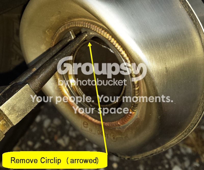

Picture 2
Next you need to remove a fairly large circlip so use a decent set of circlip pliers. Once you have removed the circlip you can simply withdrae the DB Killer using long nose pliers or similar.

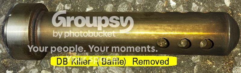

Picture 3
Picture showing the baffle removed and... no... there aren't any prizes for the first person to say " my wife has one of those in the bottom of her knicker drawer ;-)

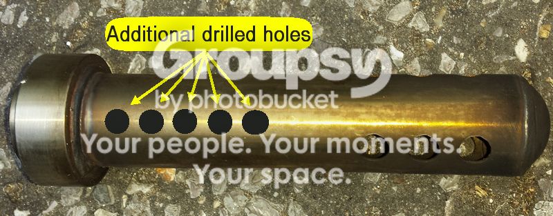

The basic idea is to come up with a method of being able to increase the volume coming from the silencer but without completely removing the DB Killer. Also, with the ability to fairly simply manually vary the volume level according to your requirements.
The standard DB Killer is a fairly simple tube, blocked at one end, with a series of holes drilled in it to let the exhaust gasses (and therefore volume) out.
Obviously the more or larger the holes the more volume would be produced.
As you can see from the accompanying pictures the original holes are towards the inner end of the DB Killer.

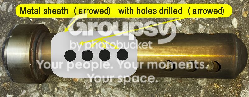

The idea is to drill some more holes in the original DB Killer but then cover those holes with a metal sheath (bit of pipe). (see second pic) Then drill some more holes in the sheath so that, as the sheath is rotated (manually) the holes line up more or less letting more or less volume out.
Quite a simple thing to do in theory though the mechanism needed to rotate the sheath will need some thinking about (I have an idea).

Showing (badly drawn) metal sheath (basically a bit of suitably sized aluminium or stainless tube) with some extra holes drilled in it. Rotating (or perhaps push/pulling) the sheath will line these holes up with the ones in the DB Killer allowing more volume out.
Things to consider include the materials used for the sheath and it's relative coefficient of expansion as the sheath may become stuck if it becomes too tight on the DB Killer. Alternatively, if it is too loose it will let out unwanted noise.
Using different size and possibly shape of hole may well affect the sound.
